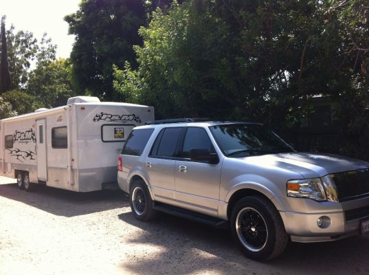

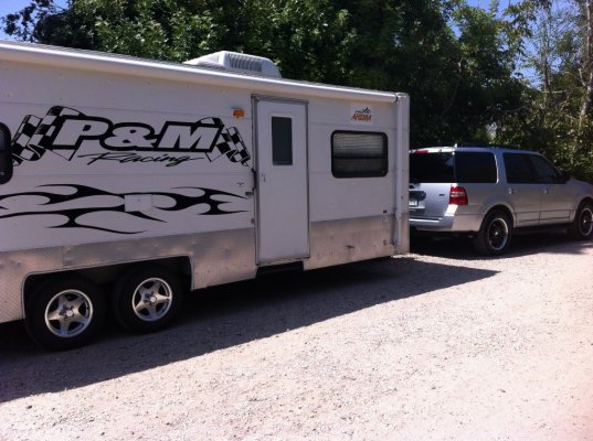

I have been towing a 24' 5500 lb race trailer (loaded with bike and gear about 7k) all over the Southwest for the last 2 years with my 10' XLT EXPY. I bought my Expy over a truck as I have 2 big dogs and I wanted an enclosed rear area for them.
Tows like a dream-anti sway has engaged just twice (once up a climb to Vegas as a semi flew past me, and once in a freeway curve sweeper). Trust me, it works as advertised and calmed my rig down. Has a WD hitch-Easily climbs up or down elevations in Tow/haul mode and cruises like a dream. I only go 60 mph or so and dont push my luck.
Rig has heavy load Maxxis tires (way more than I haul) and I just invested in my Expy with Nitto 420's for hauling heavy loads with 20" KMC wheels and a billet grill.
Here's a couple pics getting ready to hit the track-
