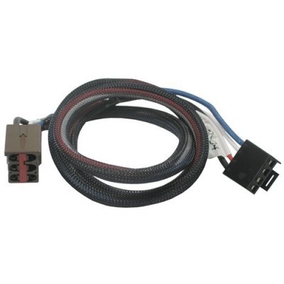

Here's a picture of a pigtail that can be used to connect to the factory controller port under the dash. Brown end goes to Expy, the black end will fit Tekonsha, Draw-Tite and a few other makes of brake controllers.

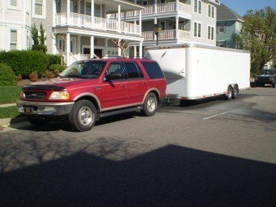

I forget the manufacturer, perhaps Reese, but bought the 7-to-4 adapter allowing to fit into my factory harness connection coming from the trailering 7-pin plug.
Granted this is a 1st Gen (97), but worked fine w/the Featherlite Trailer. Empty weight was 3860#, loaded around 7500#.
+1 on weight distributing setup and anti-sway kit. Also went w/ the roof deflecting airfoil and NoseCone to cut down on the big "square" wind grabber.

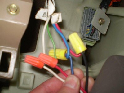

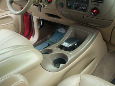

I also tapped into the factory wires to splice in the Tekonsha brake controller.
A few pics.
