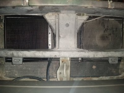

Since I already had one Hayden 679 I decided to add another. This dropped trans temps 30-40f which I consider satisfactory. Ambient temps have been above 110f for the last 30 days here and the trans rarely goes above 170f and maxed out at 192f on a long steep hill that formerly would push temps up to 220f.

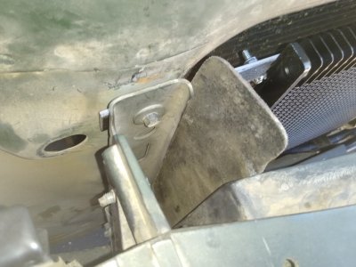

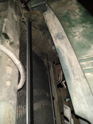

The trans coolers are mounted horizontal with tee fittings at the inlet (lower fittings) and outlet (upper fittings). I used two 1/2 x 3/16 x 36" steel straps to mount the coolers. They're bolted to the front of the radiator support, to existing bolts that happen to be the right distance apart to span the oil cooler mounting holes. I put foam insulation tape between the coolers and steel bars to reduce chafing the coolers.
The steel bars bolt between the grill support brackets and radiator support. Only needed to drill holes in the steel bars, not the vehicle. Only vehicle parts that needed to be modified were cutting the transmission lines to the aux trans cooler, and the ambient temperature sensor bracket, had to bend it straight and angled downwards to clear the cooler fins and leave clearance for the big plastic cover over the condenser and radiator.
Foam tape hopefully will reduce chafing for the cooler plates against the steel bar.

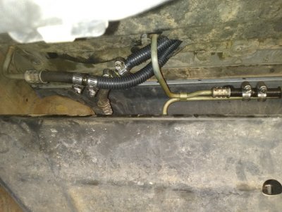

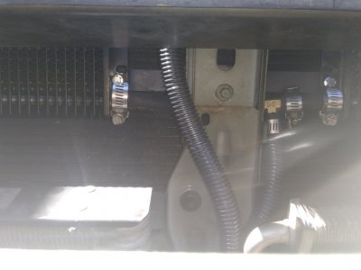

The cooler fittings are facing each other, connected with tee fitting. The lower is inlet from aux cooler, upper is outlet, goes to transmission. Covered the hose with plastic wire loom to hopefully protect against chafing.
The aux cooler was retained, the rubber strain relief on the OEM transmission lines were cut and spliced to the coolers with 3/8" connectors.

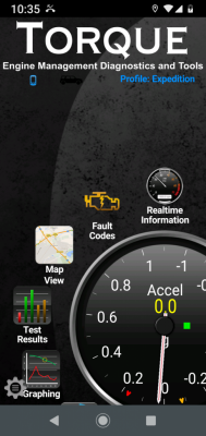

Jim - what are you using to monitor your trans temp? I'm considering getting the ScanGuage II, but open to suggestions...

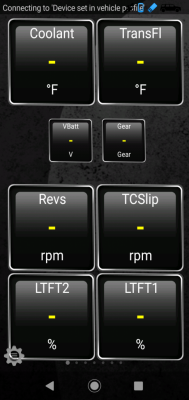

OBDLink MX bluetooth OBD-II adapter ($80-$100) and Torque Pro android app ($5 from the android play store), adding the Ford PID data set (free with the app).
You don't have to spend $80-100 on an adapter. TXFishin, a member of this forum, has the adapter at this link that works with Torque app. It's $22. He said he also uses Forscan.
https://amzn.to/3hTDbue
I like Torque Pro a lot. Not all OBD-II adapters work with the app, avoid the cheap chinese knockoffs.
The trans fluid temp sensor on the 4R100 takes temp of oil in the pan.
Torque Pro will display a bunch of PIDs for our vehicles. You can have multiple screens and types of display like dial meters or digital. You can also create custom displays like showing delta between two PIDs, e.g. difference between ECT and TFT. Other PIDs in the Ford data set (that our PCMs will report) include fuel injector parameters, cylinder misfires, knock sensor retard and others.

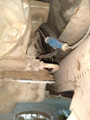

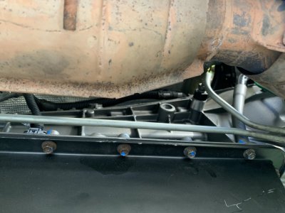

Just checked, my 4r100 has the bypass line. I think I will replace it with new OEM Ford part or rebuild it with the sonnax kit. No idea if the checkball is leaking, but after reading all the different ways to test it, the cost and time to test would be at least equal to replacing or rebuilding. IMG_20200814_155209476.jpg

I looked at mine earlier too. It is UGLY. Very corroded line, AND it looks like it's going to be an absolute joy to replace or delete. UGH !!! I guess it's time to do research.

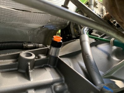

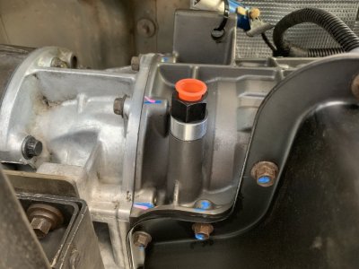

I think there's not much room at the forward fitting because of the heat shield. Should be an adventure reaching up there. Maybe a metric tappet wrench would be long enough to loosen the banjo bolt. Cleaning around it, if I can't reach my hand up there I'll tape a brush to a stick to scrub the area clean before removing. And getting the banjo bolt started gently to avoid cross threading.
I'll remove the back line first and check flow thru the coolers. 10' of clear 3/8 plastic line is $5 at home depot so I'll try the hose into funnel method and look for the proverbial 1qt in 15 seconds. The radiator is a year old, aux cooler is original, maybe there's a clog somewhere, and I'll find source of overheating, if it's not the bypass valve itself.
Too bad you found rust, but maybe fortunate to replace it now to avoid a pinhole leak later. Searching
2C3Z-7H322-BA shows two variants for the forward end. One style has a separate branching connection for the transmission pipe, the other they're stacked with a longer banjo bolt. I'll have to confirm but I think mine has the stacked style.
It makes sense the spring would take a set and cracking pressure would be less after many years. Same as gunsprings, leave a mag loaded for a long time, mag spring takes a set, and the stack of loaded ammo won't advance fast enough to feed next round.
