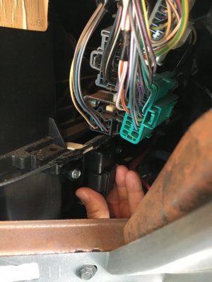

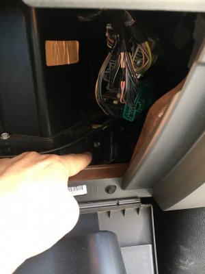

Just replaced the Heater Blower Controller Module. Wish every part change was that easy. Now wait and see if it fixes the intermittent problem.

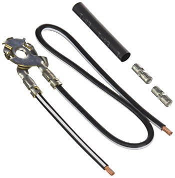

Wanted to take my wife's '10 Navigator to the "homeland" (Detroit, MI) for the '14 Autoshow, but her HVAC blower fan was intermittent. I did did my own version of the TSB with parts I had already -a red wire nut, black tape and a ring terminal to the wire and existing ground lug. I like to try the simplest solutions first. It worked great and was WAY cheaper than a new resistor. My thoughts were that the resistor was good because most of the time the fan worked as intended.

I just wanna say thank you for this thread...I had this issue, ordered a new part via Amazon.com for $70, and then replaced the part following the instructions here. Very simple, took me just under 15 minutes to do.
