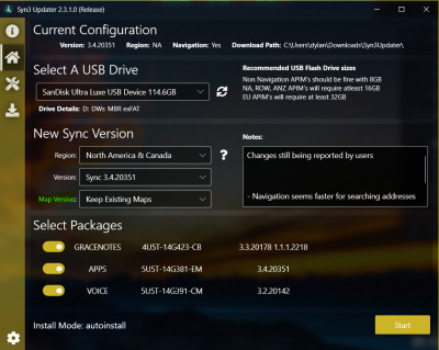

I upgraded to Sync 3.4.20351 this afternoon, so far no issues. Took 15 mins (no maps needed | already have M19) Switching apps/menu pages is noticeably quicker. I did do 2 hard reboots (power + >>) out of good habit. Will report if negatives show up.

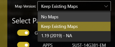

Just to be clear... I don't have to select nav (even tho I have it, assuming its up to date) each time I do an update, and can just update the Sync version? That would definitely be quicker.
DWs-TTEB
Jul 19, 2020
746
449
Evans, GA
You can just update the sync version.

Just upgraded to 351. That new installer tool is awesome. Will report any issues, but so far so good.
Sent from my SM-G975U using Tapatalk
Yup, I was nervous [emoji51] but downloaded the new installer and went ahead and updated today. Upgraded without a hitch and looks great.
Was super easy, even for someone like me who has no idea about this stuff lol
