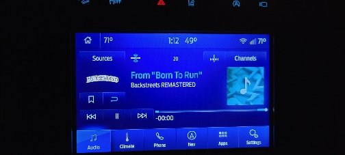

@John F I have XM and just installed the latest Sync on my 2019. I'm also missing the artwork and I can't connect to any WiFi networks. I'll report back later tonight.

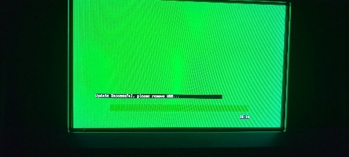

21020 took quite a long time to apply since I did the maps update as well, had to drive around for over 40min. But the update does seem a bit faster. Had lots of troubles getting the updater to download packages though, the would fail a ton, took at least 10 attempts for all of the packages to download successfully.

My updates errored out on a 32gb usb drive and finally worked on a 64gb drive.

Master Reset did not bring back album art.
I was able to connect to my cell phone hot spot but not my home network with a "...Sync unable to connect...," to my WAP. Very strange...
Tried rebooting several times. No impact. I re-ran the install again. Still no install errors. Same result.
I am wondering if it is the APIM version?
Are you forcing WPA2 or WPA3 on your AP? Have you got 2.4 turned off?
I'm forcing WPA2-AES with 2.4 and 5Ghz enabled. How do I view the APIM version? Is the Ford only 2.4Ghz?
