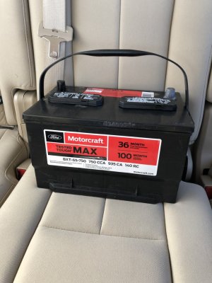

update: best battery they had was $139 plus $28.50 to install. Was surprised by the install charge but at least it went well. Batteries are trickier to install than they used to be (heard).
I told them I wanted the biggest and baddest,
which they said was the 850CCA BXT-65-850
https://www.oreillyauto.com/detail/...oup-size-65-top-post-battery/bxt65850/4495573

Stopped just now, got the cargo in back. Mine was $109 plus $15 core charge after discount.82533F7F-B029-4CA4-B3E4-10679C1E296D.jpeg

If you think that's big, ever see a Mercedes grp 49? Or a large truck battery? Makes our group 65 look tiny.
6,530
3,140
You put the battery(that's full of acid) on your seat?
It was there for the 5 minute ride yep. Not too worried about the interior on my old 07’. Cranked over nice and strong this morning.
