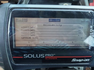

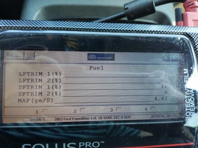

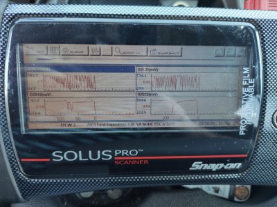

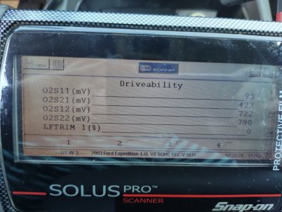

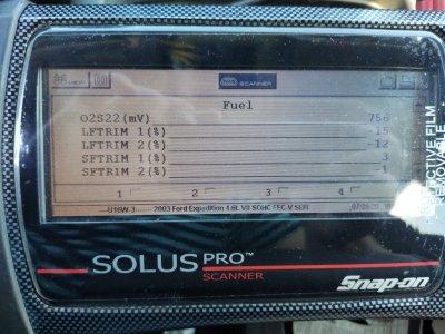

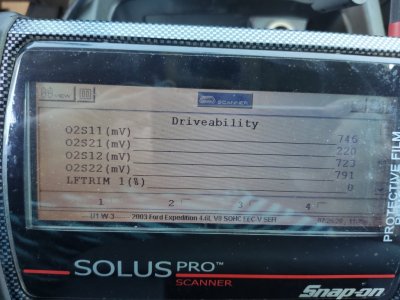

Hey everyone, so i'm still getting p0171 and p02197 (lean codes) I just replaced the intake manifold gaskets and the tuning valve o'ring (smoke checked and confirmed they were leaking). Everything is reinstalled, and the codes just now came back.. I can hear and audible hiss and smoked the system once more, no smoke visible. (I introduced the smoke from the vac line going to the hydroboost). Wouldn't you know it... the hissing sound seems like it's coming from that area, with the engine running, leading me to believe it's either the purge solenoid or the booster. When I step on the brakes and hold the pedal the engine wants to stall. My question is, is this normal? Can a faulty booster through engine lean codes? Thanks in advance,
