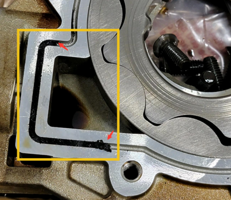

IMO, having done one now, the pump is cheap, no reason not to change it... but at a minimum, if you want to be cheap, take the plate off the pump and clean out the pressure channel. gunk builds up and can cause suction to fail/reduce, which directly affects pressure.
