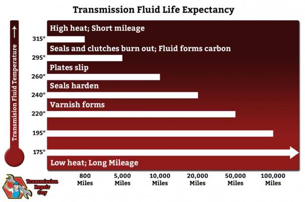

So what is the heat range you should see and what should worry you? Mid-summer driving in the south pulling a trailer, what is acceptable?

I've seen 175°-225°F as the "ideal" temperature and I've seen variations of this chart for decades and it still makes little sense to me. No way a brief excursion into high temps will shorten the transmission life by 50%. Thousands of mines at over-temperature and hundreds at exceedingly high temps I can understand.
Hopefully there's a rational explanation. :)
