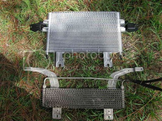

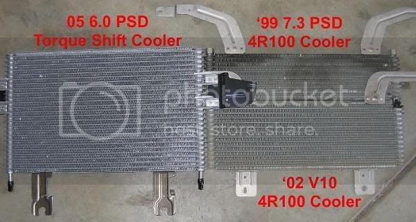

KWT2000
Feb 4, 2010
2,378
NINE MILE FALLS
as long as you keep the cooler in the radiator hooked up with what ever cooler you decide to go with it will be just fine..
here are a few pictures the 1st is a powerstoke 7.3 trans cooler (the little one) next to a powerstoke 6.0 trans cooler.
the 2nd is a 6.0 next to a 7.3 and a V10
