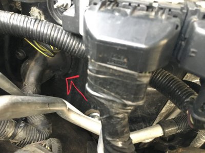

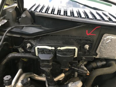

I noticed that some water are making its way into the engine bay when it's raining quite heavily. I can also hear the sound of water dripping onto the hot block and evaporating when I just turn off the car and IMG_2198.JPG IMG_2199.JPG got out. Is that normal or should I take it to the dealer?

It is from the gap in the weather seal. I'd take a look at other Expy's of the same year to see if all of them are like that. If not, warranty repair.

Mine looks about the same as yours (see photos). Any chance the drain hole near the gap in the weather strip is plugged up?

I'm going to take I look, this problem has been around for quite a while, so I'm not sure if it's just plugged or is that a design problem. It wasn't on my top of the list cause there weren't much rain in spring.
