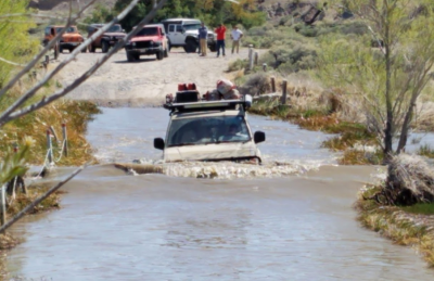

Guys. I've been searching all around for water fording depth of the 3rd gen Expedition EL (2017 EB). I'll be headed to Mojave National Preserve in California. There are a couple water crossings that may get as deep as shown in the photo below. Wondering if I should avoid these.
From what I've read on this forum, looks like earlier generations did ok with water fording, but 4th gens can't go above wheel hubs due to risk of damaging electronics and taking water into diffs and tranny.
How deep can we ford in our 3rd gens? What preparations can I make to avoid damage or water contamination to driveline components & lubricants if water gets deeper than wheel hubs? Do we have breather hoses on our diffs, transfer case, transmission? If not, are there kits available? Are the seals from half-shafts to diffs adequate to keep water out?

Rockaway Beach, NY
I believe the owners' manual says keep the water below the hubs. You can go deeper, probably as deep as the transmission and differential vents, as long as your pockets are deep enough to replace the stuff that rusts and shorts out in the year following. That's how long it will take for any leaking electrical connector and bearing seals to talk to you. And they will.
Look to see how high the vent hoses are. They are tie wrapped to stuff at the factory and often slip way down or fall off their nipples. All the seals when new are designed to keep out water, but after eight years, who knows what shape they're in? One way to find out though.
Good luck with door seals. And good luck with the coils. They don'l like water on a good day.

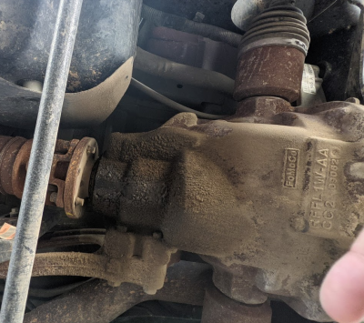

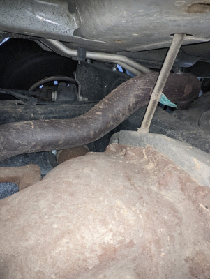

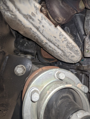

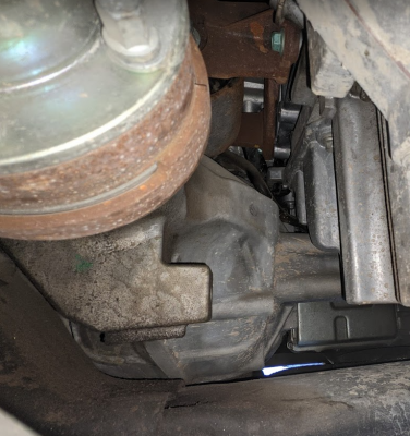

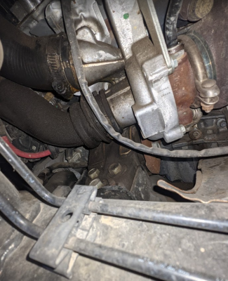

So I stuck my cell phone camera up where the sun don't shine... took a few photos of the rear diff and attempted taking some photos of the front diff & tranny (mostly obstructed). All photos here: https://photos.app.goo.gl/xU2Gp3safcVWwtmy8 Here are a few observations:
1) Rear diff does have a diff breather with a tube running up through the body.
2) Front diff was too obstructed to see any situation with a diff breather/vent tube, but I would hope that if Ford went through the trouble of vent/tubing the rear, they would have done the front. But you never know. Can't really see shit in the 3 photos below.
- Facing forward, just to the left of the front diff pinion bearing/seal.
- Just below and to the right of the same pinion seal, facing up, looking at part of the front diff.
- I honestly have little idea how I got this shot. I think I stuck my cell phone up through a crevice and above a frame member (bottom of photo) and snapped a shot of the compressor side of my driver's side turbo (top center)
3) Ignition coils on the EB (Direct Injection/Direct Ignition) are over the top of the cylinders/spark plugs, which puts them at about the top of the wheel well, which is about 37" above ground. I understand there are other electronics to be concerned with.
4) Hub center is about 16" high. 34" tires + ~1" lift w/ Bilstein 6112's.
I have not fully considered the hub seals and understand that could be an issue if submerged excessively. But I wonder what issues a 20 second ford through a 30" high river would really create...

I agree with your analysis, ShinySide.
I'm unsure of the door seals and the transmission vent. I doubt there's any venting hose on the tranny, so you would be limited by the location of the vent and its bulkhead connector. Also see where any body openings are in the jambs. See how low the window motors are as the doors have drain holes with plugs that probably won't seal. Same with the tailgate and its openings.
Remember that the door weatherstripping may not hold out water and that wouldn't be fun. Also some cars come from the factory with one or more drain plugs missing under the carpets. Look for the backs of them in the floorboards.
