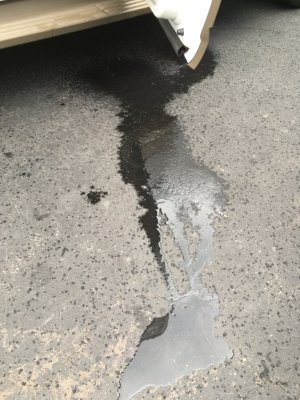

Opened door and water started dripping at corner.
Goodly amount.

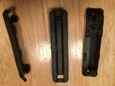

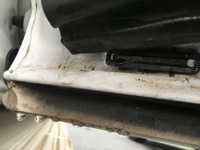

Investigated a bit and found 2 weep slots under bottom weatherstripping, with plastic inserts. Jiggled the inserts and water started flowing. Pulled insert out & found wet oily goobus behind it, plugging/blocking any natural weeping. Same deal on another (rear) door. NOT GOOD for long term health of door!! water tends to drip out at door corner (by design). I'm sure its impossible to keep water out of door (window seal for example) but it needs to keep moving ... cant freeload here.
I'm pulling all 8 inserts, going to use shop vac to pull all the crudd out ... and will monitor. I see no reason to put those inserts back in. Might be a reason but I can't think of any. Weep holes too small for mice to use as an entry point.
I think the Krown treatment contributed to this situation (theory). Not complaining, but advise if you do Krown (or anyone else who cares) ... check for this to avoid the door being a water collection device.

If anything I think those inserts might help keep mud from building up and blocking the holes they snap over.

Yes, the plugs keep dust and dirt out. In some markets, dust is a big problem.
If it's not a problem where you are, just throw the plugs away. Probably best to leave them there and take a look at them and clean them out every few months.

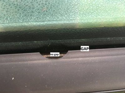

Getting water out is a good thing but how to stop water entering in the first place? All four doors on my 2008 has a sixteenth inch gap at bottom of window outside rubber. How do I close that gap by forcing rubber against glass. That should at least slow water entry if not stop it.

I'm thinking its like some parts of roofing or flashing house exterior. You just want water to fall and pass on through. Sometimes (in exterior work) caulking can cause problems. I don't think its possible to stop water coming in at the window. Just my opinion.
Where is the 1/16" gap? On all 8 of my windows theres a top -- hard plastic "shield" with a small gap & below that a soft rubber squeegee up against window with zero gap. Its at a small angle wrt window to maintain contact. All the water that gets in between those two parts … has to flow downward?

Your picture is right on. The hard rubber and then the wiper strip. Is that wiper strip adjustable is my question.
Now, my 08 expedition XL had a hard rubber at the bottom of door windows there is a big gap there between glass and rubber. Water is forced, allowed, to run inside door there.
Below and inside the hard rubber is a softer, flexible, felt covered strip that is to touch the glass. I think it is to act as a wiper, but it doesn't. When outside window is wet and I operate window it should wipe water from glass, but it doesn't.
If I could get the wiper strip to touch glass it might limit how much water enters doors. That might have helped control moisture inside doors that rust cables, motors slides.
