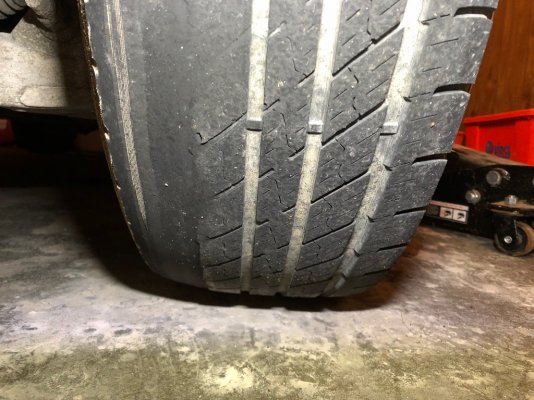

To say the least, the wear pattern looks a little uneven on my MIL's 2005 expedition front tires...

Wow. Never seen tires like that. Hope you nail it. I think you said all 4 tires were like that? Is that from tire rotation?

Just the front, and much worse on drivers side.
So, after you install the new parts .... alignment ?

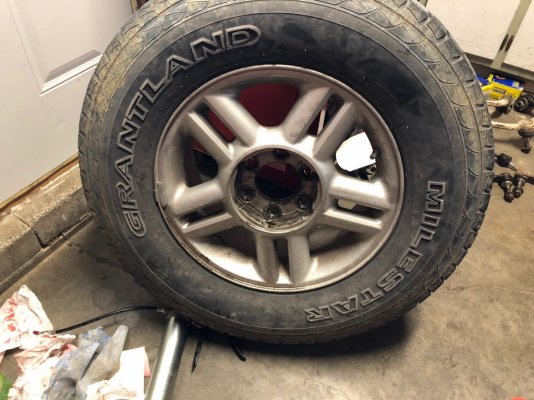

Anyone heard of the tire, Grantland Milestar ?? Any guess on who makes these generics?

Tire sounds like on of the many Asian brands flooding the market. Be sure your turning the lock nut on tie rod the proper direction. Just check the new one for rotation direction. I've had good luck with Moog parts, but always install their premium stuff, every company makes an economy version, I'd stay clear of those. Your new parts should have grease fittings, be sure to lube them for mama in law , every 5k. Makes them last way longer.
