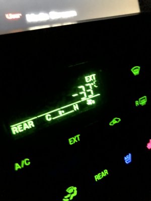

so, I was driving down from Lethbridge, AB back to Salt Lake City, UT for Christmas, and it got really cold in Montana.
That’s about -28°F for all you Americans.
Anyway, I was chugging along just fine when I heard a strange noise from the front end, it might have even been road noise, it was so faint, but it could have been the IWEs. I heard a faint clunk, almost like the IWEs make sometimes when selecting 4A (something I had been doing frequently with as bad as the roads were in some spots) and the noise stopped. I thought nothing of it until about 20 seconds later when I heard a chime, the parking brake symbol lit up, and the display read “CHECK BRAKE SYSTEM.”
This is not something you want to read at 3am in the Montana mountains when it’s -34°C outside and you’re rolling down I-15 at 75mph.
