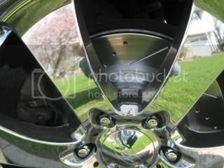

just picked up my xp 10 minutes ago with new brakes all around...
i bought DRT rotors...cross drilled/slotted...
(right from the ad)
Feature:
Longer rotors life
Prevent fading
Prevent warping
Reduce stopping distance
Better stopping power under-wet condition
CAD programmed
CNC machined for precision and balance
Zinc plating to prevent rust (silver)
Holes are chamfered
3/16 holes are much stronger over competitor’s ¼ holes
Less material being removed, more friction surface
also had ceramic pads put on(supplied by shop, dont know what brand)
my mechanic drove it around today to brake them in alittle...when i picked it up, just driving a couple blocks it feels like they bite alot faster and harder...its a major, noticable improvement...and FINALLY the brake squeak has stopped...not to mention they look dead sexy behind the wheels...
pics are just of the front
edit: if i were to have supplied my own pads...it would have been EBC green stuff pads...heard good things about them
