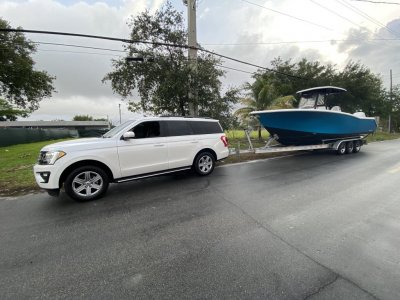

I have a Tow Smart from Home Depot with a 2 5/16 ball on it. My boat is close to 9,000 full of fuel and I have the XLT, doesn't seem to sag too much considering the weight. First time towing with it and it does a lot better job than the Tahoe I had.

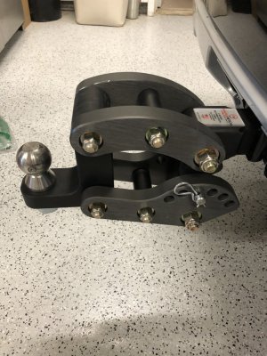

I just got a rhino hitch. They’re really pricey but also really nice. Let’s me have full adjustability up down without having to unhook. Makes getting the prop guard up high enough to back over the curb into my yard easier50191C77-6996-49D0-8C69-3AEDB6915D50.jpeg . And then I can level the trailer to tow without unhooking. https://rhinohitch.com/

Those are nice, they are made local here in Utah. Does it fight tight in the receiver?

I like the concept of this. I just wish it was shorter when level, because I like to leave the hitch attached. It looks like a shin killer!
I currently have to switch out the hitch to a 9.5 inch drop to clear the tower when backing the boat in the garage. With most hitches, a 9.5 drop would drag frequently even if the ball was up at a 2 inch drop position. This would eliminate dragging issue since it is high off of the ground at the ~2 inch drop position.

The worst thing about that big cluster-F is how far the ball is extended rearward. Thats just additional leverage to force the truck to squat more. I cut and re-drilled the receiver on my 3/4 ton specifically to reduce this additional leverage. A little bit makes a pretty noticeable difference.

Yes. Keeping the overhang- the distance from the rear axle to the ball- short improves towing.
