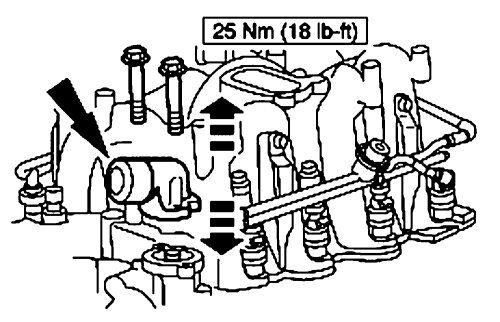

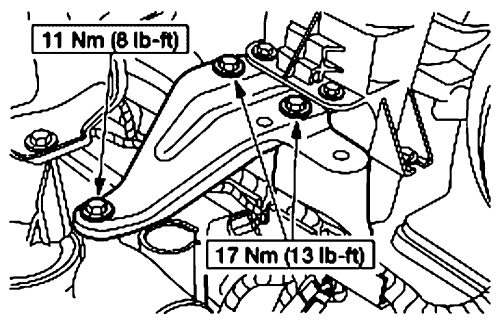

AUTOZONE HAS A PRETTY GOOD WRITE UP ON HOW TO
4.6L & 5.4L SOHC Engines
Partially drain the engine cooling system to a level below the thermostat.
Disconnect the upper radiator hose from the water outlet adapter.
Remove the power steering reservoir upper mounting bracket.
Remove the bolts and remove the water outlet adapter.
Remove the water thermostat and the O-ring seal. Discard the O-ring seal.
Installation is the reverse of the removal procedure. Tighten the water outlet adapter bolts to 18 ft. lbs. (25 Nm). Tighten the power steering reservoir upper mounting bracket as shown in the accompanying illustration.
Fig. View of the power steering reservoir upper mounting bracket and tightening specifications
Fig. Exploded view of the water outlet adapter and tightening specifications
