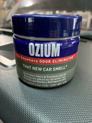

Mine smells too. I think the interior might have gotten taken out then put back in wet. i use black ice trees, also, we sell spray called oZone? at advance auto. designed to get bad smells out. crazy strong careful when using it. think it comes in odorless, new car, and another black ice type smell. havent used it yet but heard it does wonders.

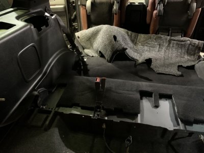

Sounds like it is from wet dogs from the previous owner. My 04 was the same way when I bought it. It was in the rugs.
First off, my father is a used car dealer, and between working for him, and for 2 large new car dealerships, I have seen a lot of different ways of detailing/cleaning the rugs of a car.
Until a few years ago, I always sprayed a cleaner, sprayed a good amount of water on it, and went to town scrubbing it. Recently, I saw something that not only worked better, but dried out quickly. The detailer used full strength (or not very diluted) Simple Green or Grease(d?) Lightning. Spray it directly on the rug, scrub with a scrub brush, then vacuum clean. This way the matting underneath doesn't get saturated with water, and mold while drying. Your mileage may vary, but I did it in my 04 using Heavy Duty Fantastic, and couldn't be happier.
