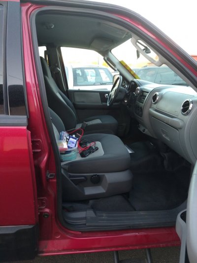

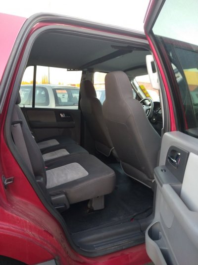

I just bought a 2006 72k miles. Used to be a Fire Vehicle so it's as basic as it can be while having lots of weird excess. Well maintained. Whisper quiet. Radio, CD player & Cassette Deck no Aux plug in or Bluetooth ... Might just say it all. Key had no chip in it. It's rather weird to know I can go make copies for $5 vs $75
Have put about 300 miles on it since purchase and it stalled while driving. Thankfully I was in a safe place. And all the security stuff went out - auto locks, clicker, rear hatch opens randomly - lots of fun.
This forum has helped me narrow down some potential Why's. I'm leaning towards ground wires that have jiggled lose, and fuse box/relays that need replacing.
I haven't dived into mechanical since about 1995 and not had a Ford since my parent's collection. Dusting off the knowledge. Hoping some might still have value. I think this 9ne is simple enough, aka not much computer on it, that it's in my basic range of aptitude.
