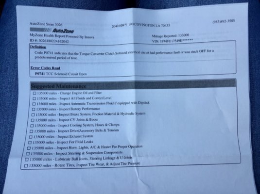

The front hvac heater blend actuator, and the rear one is going out. Aggravating clicking in the dash and the passenger rear.
Also, a green wrench light has come one a few different times, with nothing noticeable ever going on. Would it be that the transmission trying to learn my driving? Two times that it came on, I brought it to auto zone and o’reillys, and pulled a P0741 code. When the wrench is off, no code was pulled (one additional time I brought it to autozone just to see).
It’s an 09. I am the 3rd owner. 1st owner drove it 122k miles until 2015, and 2nd owner drove it 11k miles in the next 3 years bec he lived in a retirement home, then passed away, and willed it to his brother, who sold it to me.

It does nothing out of the ordinary if and when the green wrench wants to appear. It’s mainly happened while in cruise control on the interstate at around 60-65mph after having drive for about 45 min to an hour.

Sounds like the TCC alright. That's a situation where it would definitely want to lock up, and apparently it can't. You'll probably notice a gas mileage decrease (or an increase once you get it fixed.)

I was able to get this reading while the light was on. No code will come up while the light is off.

Yep. It’s got a bad solenoid probably, the computer is attempting to close the circuit but it doesn’t appear to close. Also possible it’s a broken wire somewhere, or a bad pin in a connector. That’s about all I can tell you, though.
