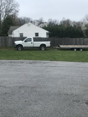

I tried to tow a John Deere skid steer to WV from MD with that truck and only made it about 10 miles and parked it at my cousins house. I had to get him to take it with his new 6.7 F250 which of course was effortless. Now to be fair I had a Western snowplow in the back of the truck along with skid loader weights, tire chains. On the trailer 2 different buckets, steel tracks, and forks along with the 8,000 lb. John Deere. That 5.4 3V wasn’t having it! It just wouldn’t rev up even to the floor on take off just bogging and telling me no way. I was surprised and never had a truck lay down like that before even under severe strain. Maybe something is wrong with it? My old F350 360 FE dump truck or my old 400M F250 would both have broken the driveshafts before they would lay down like that. By the way that little 10 mile struggle to my cousins house is what blew the exhaust manifold. I’ll give it the benefit of doubt and say there is something not normal about it’s performance.

Yeah I never made it to the mountains.... I pulled the plug on that turd on flat ground. It just wasn’t up for the task.
Generally an early sign of clogged catalytic converters is poor towing performance on mod motors many mechanics say, just one theory. That could also warp a manifold with the excess heat build up.
Definitely sounds like something was wrong with it, if you blew an exhaust manifold from towing, almost makes me wonder if the mufflers or cats were blocked up, or some other exhaust blockage which would definitely explain half or more of what you say you felt.
Could even be some employee took it off road and dented in the exhaust pipe by bottoming it out or something stupid like that. But definitely not running the way mine do.
