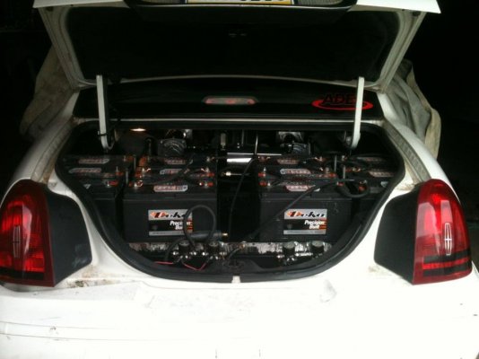

OK I watched several YouTube videos on adding a second battery and I'm pretty sure that I could use 31 group batteries with 1000 CCA for my needs.
The pricing on Deep cycle batteries and the fact it's not recommend to use as main battery like mentioned above..
Plus I'm very familiar with theses 31 group batteries as I run 96 volts in my Lowrider and plus I already got them...Hahaha
And I know that they work fine as a Main battery and they do good .
I just want to double my run time
I jus gotta order a wiring kit that allows me in able and dis able the second battery via a toggle switch in the cab.
