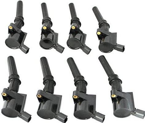

I have some COP's with this small bar in the boot 'spring', looks like graphite (maybe not). I was wondering what it's for?
Some of my COP's have them some don't.
Thanks in advance.

That would be my guess. Are you the original owner ? Are the coils with these in them originals ? I would guess they were installed by somebody to cut down on radio interference?

That's interesting. I would have thought it had to do with conduction from coil to plug.
Ham, I am not the original owner, and replaced 6 of 8 coils.
Here is another shot with 'bar' in situ.

Good question...and one I will be asking soon, I think. I need to give mine a tune-up, since it throws "Cyl x is rich" failures in the OBD. I am going to be replacing the COPs as part of the tune-up. My guess is that the bar is there to avoid kinks in the wire and to force it up out of the way, but I haven't been into the COPs on mine yet. I had something similar in my old MR2 in the plug wires.
Thanks in advance.
It's not graphite, it's ferrite. Researched several years ago when changing my factory COPs out the first time. One (and only one) of my factory COPs had the ferrite slug in the spring. It was in pieces. None of the new replacement COPs came with the ferrite slug.
IIRC, the intent was/is to mitigate RFI (radio frequency interference). I carefully removed the pieces when changing the COP. There may be a barely noticeable difference on the AM radio band running without the ferrite slug, particularly with increased sensitivity to driving/parking under or near obstructions and areas with overhead power lines, etc. I.e., areas already prone to interference with or without the ferrite. If so, it was marginal.
I notice little to no difference when driving in open areas with a strong (unobstructed) signal, and none on the FM frequencies.
Thanks. And interesting. Never would have guessed. Noticed it wasn't graphite (would not leave a mark on paper or the wall in my house lol). So it only effects AM? Never tune into AM so I guess I'm A-OK.
Thanks again for the feedback.
