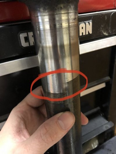

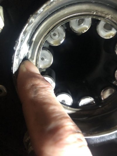

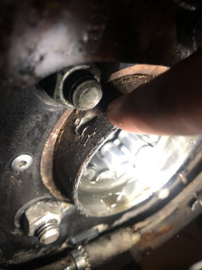

I just got done replacing wheel bearings/seals, passenger side axle shaft, parking brake shoes, rotors and brake pads. Haven't had a chance to drive it yet. The passenger axle had some wear on it where it sat in the bearing. It didn't cut a groove into it, but the stock shaft had little factory grooves around it (will try to include a pic below) and they had been worn down to smooth metal on part of it. It may have had something to do with the the large dent someone had somehow put in the axle tube housing right in front of the bearing. It made getting the bearing out an absolute nightmare.
Anyway I got all the parts replaced, now i'm just hoping no leaks develop. I really did a number to the inside of the axle tubes, but we'll see what happens *fingers crossed*

Here you can see the wear on the axle shaft.
And here you can see the dent that somehow got put into the axle tube housing. I heated it with a torch and tried to hammer it out a little bit and also hit it with a die grinder. This whole job on both sides was quite a chore. Almost wish I would’ve just bought a whole new/used rear end. And who knows, if the seals don’t hold I might still have to!
