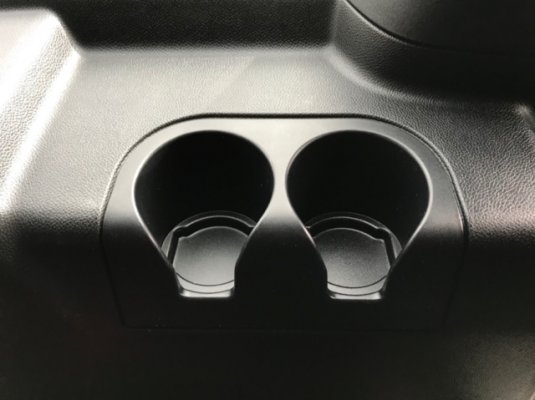

Has anyone removed the cup holders for the port side, 3rd row seating area? Any idea what's below them? From the vertical edge of the interior wall to the sheet metal is a significant width and I'm wondering if I can fit some electronics in there forward of the sub woofer.

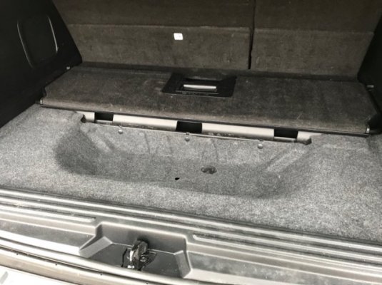

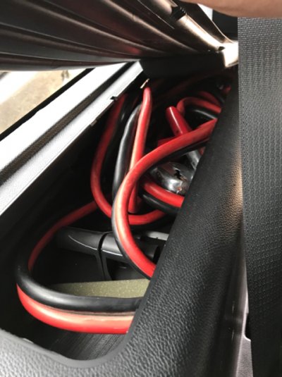

Moss, you’ve found my secret storage location! Pop up the cup holders and pop off the trays on both sides and you’ll find gobs of room. I have all of my emergency tow straps, heavy gauge jumper cables, flares, safety vest, and a bunch of other junk below those plastic shrouds. In fact, I removed my jack and tire tools from the shallow well in the floor, and put them in there too. So now I have a shallow well for my groceries to sit in. Best mod to my truck so far. So yes, explore in there...you’ll be thrilled by the amount of room inside. I’ll try to take pics today of my setup.

Does the cup holder assembly simply lift out? Is there sound insulation inside this cavity? Thank you.

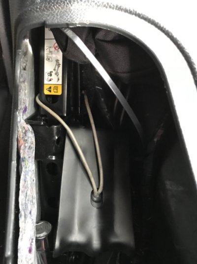

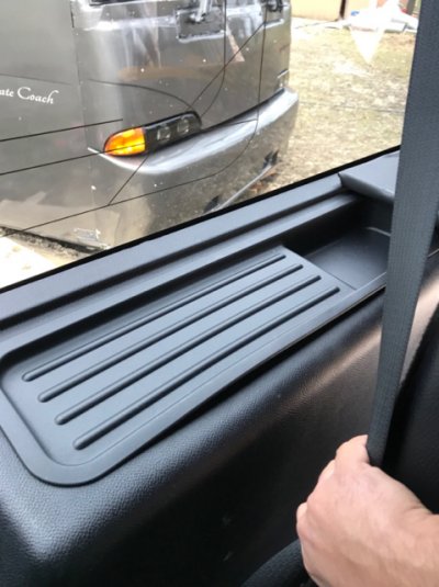

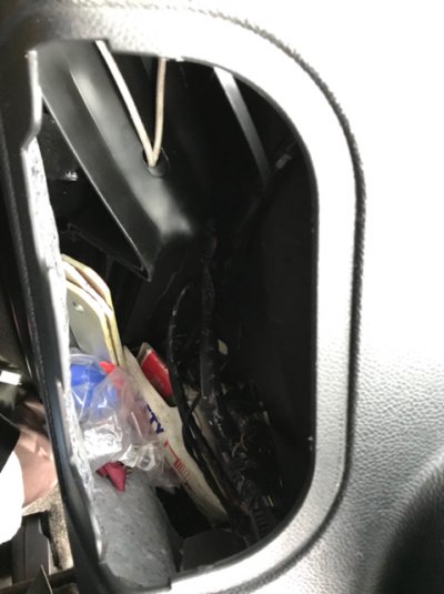

On my ‘15 EL Limited the cup holders just pop out. Also the trays lift out too. And yes there’s some sound insulation in there but not much. Here’s some photos. Not sure how much they will help, but I can tell you I have tons of random emergency junk in these areas and have room to spare.

Muddy, thanks for all that- great info man! It looks cavernous in there and that's exactly what I was wondering about. :cool:

A bit of a job taking those side panels off if you'd like to completely remove them. You have to take off the rear trim and the rear seat belts. The right side contains the rear heat and a/c if equipped, under the tray. The left side contains the sub-woofer housing, again if equipped. I took my XLT's left side apart to install a factory sub woofer and Ford amp. I removed the right side tray to replace the blend door actuator motor twice.
