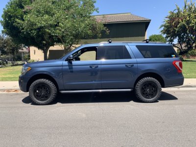

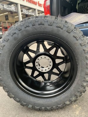

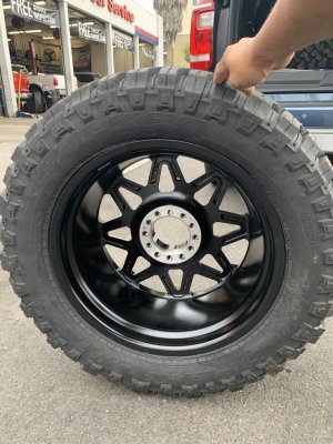

Below are the two wheels that had the tires remounted and balanced (before photo)
Wheels and tires mounted on the rig.

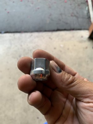

Last photo are the lug nuts supplied by Extreme Customs.

70 ft lbs????
My 08 I torque them to 150...
Well...color me dumb.
That being said I’ve never used huh centric rings before so would it be wise to use them this time around?
sjwelds
Feb 19, 2016
838
383
Kansas
Dunno on the rings but you better look up the proper torque for your year, I don't wanna be responsible for snapped wheel studs lol
