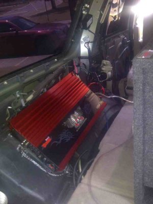

Underneath 2nd row seats unless the amp is too big…I think 3 of us put our amps in the panel where the factory sub woofer is…if u do this u will need a fan or 2 to keep it cool…as u can see I took out my factory sub

no...there may still be room...theres still space in there to put a amp pending on size...if you do...buy fans to install in there as well cuz it will over heat due to no air circulation...i had that prob while trying to find the right/best fan...works great...no probs driving from VA to FLA

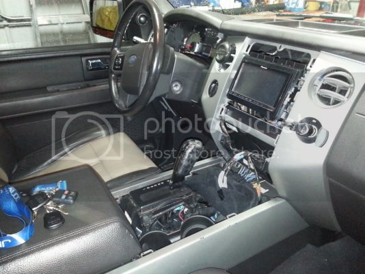

I couldn't come up with anywhere that offered enough room and hid the amplifier well enough but allowed me to continue using the vehicle the way it was meant to. I ended up stuffing my HD900/5 into the dash under the radio. I left the factory subwoofer in place with plans on building a new box in its place, but ordered a JL stealthbox instead.
These 3rd gens are crazy packed with all of the modules. The HD900/5 is probably the largest amplifier you can fit in the dash. Mine was a tight fit.

You can see in this picture how it finally sits... thankfully I could make it work like this or getting to the adjustments panel would be a you know what.
These are from when I was test fitting right before finally deciding this is where it was gonna stay.

Nice, but how you deal with the heat in there?
Don't need to. The amp doesn't get that hot to begin with and the HD series have what they call "rollback protection". If the amp gets too hot, it slightly reduces power output until it is safe to increase it again.
