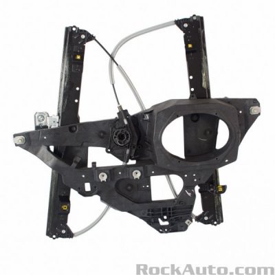

I was driving and heard what I thought was something hitting the glass. I saw no damage and went into the store. My wife was in the car and when I got back she stated she pulled the window down to smoke, but the window would not go back up. I can hear the motor but nothing happens. I'm thinking it is the window regulator. I confirmed this with Safe Lite Auto Window and the service dealer in Danville Va. Not ever repairing one of these before, I view some videos on how to replace the window regulator, which were good. But all of them started with the window already up. None of them show how to get the window up when it is down. I need some help.

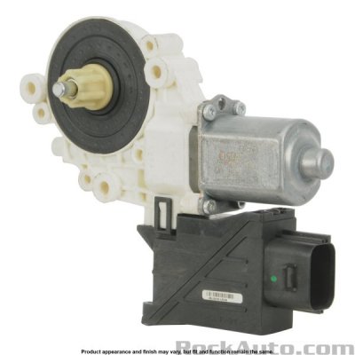

Can you grip the glass and push it up with your hands? Take the door panel off and examine the window motor and regulator to see what has actually failed. Just to make sure it's not the motor's gear, and it is in fact the regulator that's failed. If you remove the motor from the regulator you should be able to move the window up by hand. You have to get it to a position to access the 2 window clamp bolts anyway.
Motorcraft WLR-187 https://www.amazon.com/dp/B00HFLGHC...10&ie=UTF8&vehicleId=7&vehicleType=automotive

I have not taken the door off yet. I order a regulator about an hour ago. But I can't pick it up until later tonight. The motor is making some sounds when I press the button, but no window movement. Where do I find the window clamp bolts?

Had the exact same failure last weekend on the driver's side front door on my expedition.
What I did was just pull the door panel and unhook associated wiring, and then I cut the cables that were jammed. I then reached down and lifted the window by hand, and held it in place while my wife taped it up on the outside with packaging tape.
I watched fordtechmakuloco's video on it. Very helpful.
Good luck!

On each regulator window clamp attaching point. Where the glass rests in the regulator tracks.

After you get the glass to the top put 2 or 3 strips of packing tape up over the top of the door but make sure they are holding well. Instructions for the regulator install are in You tube, I found three of them. Less than a one day job even if you never did it before. I paid $45 for mine and it works great.

Had the same issue, it was the thin Bowden cable that is inside the regulator had rusted and broken. As stated, I removed the interior panel of the door and was then able to loosen the two clamps that attach the bottom of the glass to the regulator and lift the glass out, then removed the regulator, I made up a new cable and it worked perfectly but you can also buy a new regulator mechanism..

Picked up the regulator this morning. I could not fix the old regulator....it was cracked in two places. Anyway, to get the window up, I used two long screw drivers at the bottom of the door and lift the window high enough so I could grab it. My old Chiton book was very little help. Anyway mission accomplished. It did not take too long....if I had knew what I was doing, I think I could have done it less than 90 min. Biggest issue was the gnats flying around my head, that almost made me lose the door handle spring. Thanks everyone. By the way Safe Lite estimate was $289.00 not including the part. And the Ford dealer was almost $700 with it.

My 07 Expedition had this occur 2x on drivers side, once on passenger. You should be able to pull glass up manually as the cracking sound you heard was probably the attachment mechanism separating from window. Ford finally beefed up the mechanism on later models. My 12 has over 125k on it, never been an issue.

It seems like all the earlier models have the regulator go out. Mine was out when I bought it which is probably why I got a good deal on it but I fixed it for about $50 right away. That was the ONLY thing wrong with it and it is the best car I ever had (I had 50 at least).

LOL! I am now on my third '07 driver's side window regulator. I'm getting pretty good at swapping them out. LOL! It's not hard. You will want to buy a package of shims (wood or plastic) if you don't have some already for other carpentry projects. You'll want to slip them down between the outside of the door and the glass to keep it in the position you want without having to hang on to it!
