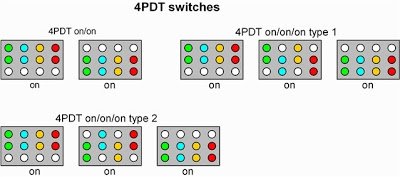

"Thevalleyboy" - Thanks for this great post!!! (and others who also posted stuff). This is definitely a great mod! My Expedition is the same year, model and options as yours. Are you able to provide the colours of the wires and where (in the switch) they go? That would be a gr8 help!!!
06king
Apr 13, 2012
28
Ontario, Canada
colour of wires & Switch location
Any of the guys that have done this mod... do you know the colour of wires & their Switch location?
Thanks...
