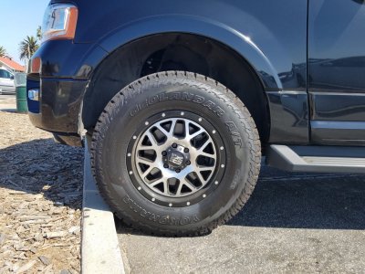

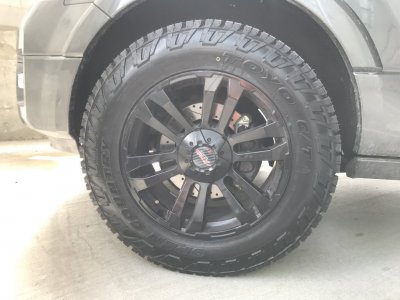

BFGoodrich KO2 all terrain tires are one of the best off road tires on the market and the most quite tire I've owned. At all speeds on the pavement, this tire is quiet no need to turn up the radio.
