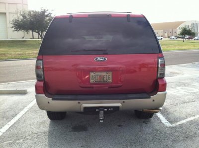

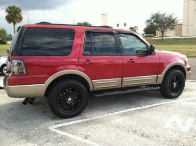

just one quick question. wat did you do with your exhaust because i thought of doing a costume one for mine but not sure if i can make it duel and still keep the spare tire
14,561
888
Hampton, VA
you can...just have to go under the IRS and turn them out behind wheels or straight out...you can even go with a smaller diameter pipe to go through the IRS...both have been done by ppl on here

yeah but i have to get pics so i can show the shops around my area because they say it cant be duel exhaust. but i want to make it a true duel like the 96 to 00 explorers
Shadowless127
Apr 13, 2012
72
Long Island, NY
A lot of shops don't like doing dual setups if it involves relocating a spare tire, or routing the exhaust in an unconventional way. If you find a shop that specializes in high performance exhausts I'm sure they will figure out a way to do it. I ran into the same problem with my Explorers over the years; no one wants to do duals because I'd have to ditch my spare tire.
14,561
888
Hampton, VA
look up knautical2001...he posted pics of his dual setup that runs under the IRS...thats what im going to do...
