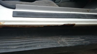

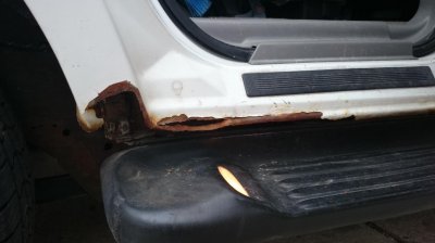

Anyone now how much it is to fix this? Or is there anyway to do it myself?

best bet would be to take it to a body shop get an estimate on parts and labor and the decide if you want to do it yourself
stamp11127
Mar 10, 2012
6,218
1,250
Temple, Georgia
Not worth the investment considering the amount of work to do it correctly. What you don't see is the rust that hasn't made it out to the paint layer. If you didn't stop that rust you would just be chasing it from year to year.
It would be more cost effective to head south and pick up another gen 1 that hasn't been exposed to the salt.
A few years ago we had one of the Scion XB's that a "terd head" keyed two of the doors. Cost of fixing that was $1200 - no body damage, no rust, just filler and a paint match.

I was looking around ebay And the Rocker Panels are $78 Dollars and I will Upltherere pictures because that isn't all the rust :(

I have the same exact problem with the rocker panels on the cheap way that I know of is spray foam mesh and bondo but im not sure how long it would last and theres no guarantee it would even work
FordandPolaris
Feb 7, 2012
2,247
263
Saint Cloud, MN
In my opinion the foam will hold moisture if it ever gets even a little bit wet. You can purchase new rockers and weld them in, and then bed liner the bottom six inches of the truck (saves on the paint match). That is about the only way it is going to be an alright price.
I bondo'd an entire fender where I took off about 4 inches of rust/metal up until I was back to good metal, and it still rusted back through in about 2 years.
Honestly given the amount of damage already done though, find another Expedition with way less damage and fix it before it gets to that point again. My truck is to that point too and the truck simply isn't worth the time and money.

I cut out both sides of mines as they were really rusty and welded 2 new ones
