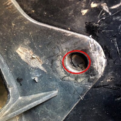

I replaced the rear window gasket and the right glass hinge to stop a water leak at the back window. The hinge was cracked almost completely across. The only think that was holding the hinge on was the plastic piece that goes between the hinge and the glass.
The one thing that I noticed is that truck got much quieter. The gasket and the stopping the leak must have eliminated some air noise and it doesn't rattle when you go over bumps.
I had to buy the hinge and the gasket from Ford. I also bought the glass screw and the screw for the hinge to the hatch frame.
