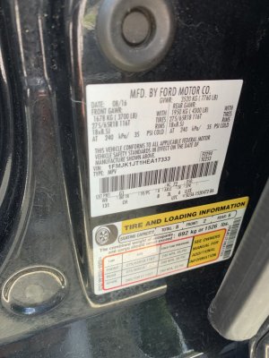

If anyone has an Expedition with factory LT tires I'd be interested in seeing the rear GAWR as listed on the data plate.
My Expedition's Gross Axle Weight Rating (GAWR), the maximum permissible weight on the rear axle, is 4300 pounds. This can be achieved with the recommended cold tire pressure of 35psi in the rear tires. Normal inflation higher than that will just wear out the tread center more quickly (although radials minimize this).
The GAWR doesn't change if I put 40psi in the tires or put harsh riding LT tires on the truck. At 51psi (max cold pressure) the pair of rear tires will support 5512 pounds -- but the axle and suspension won't.
-- Chuck
-- Chuck
Correct! It also doesn't really matter what the name plate for the manufacturer says. No tire should ever be loaded beyond the maximum load stated on the sidewall and that is at the PSI rated also stated on the sidewalk. You should never inflate a tire over the max pressure listed on the sidewall. If you do and you're trying to overcompensate for extra way you are already breaking safety rules by overloading the tires.
