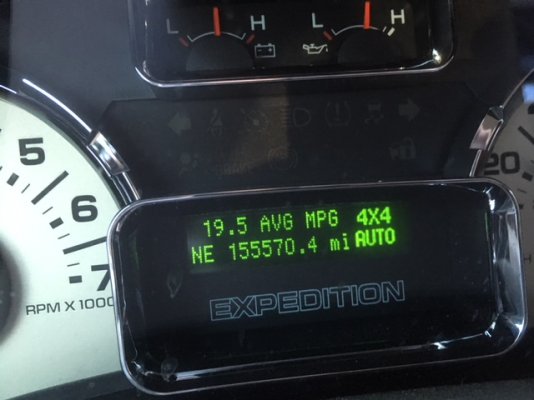

So I just bought a 2009 EL a few weeks ago. Previous owner did not clear the onboard computer and it read 9.2 MPG average. I figured he must have towed a trailer or something. Long story short, best I could do was 11 - 12 MPG, city/hwy. Put new plugs in it last week even though it was running smooth. Now getting 20.4 on the HWY (60 MPH on Cruise Control for approximately 100 miles) and 14.9 city. And for the non-believers, here is the screenshot to prove it. Loving life in the new Expy now.
