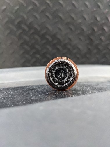

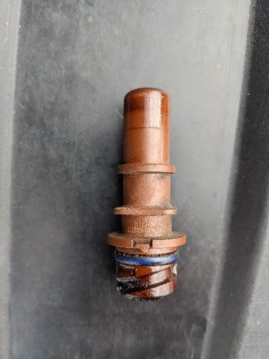

To be clear for future readers - was the culprit the PCV solenoid? If so, which part number did you have and which one did you replace it with? If I remember correctly they are up to the third iteration of this part for your year with the original part being black and the most recent versions being red.58373d93103477f2d8ded0756a634147.jpgf0b4a50416296b51d0c48228684e94ff.jpg

How difficult to remove the PCV valve?
Does it pull out, or twist out? Is it one the left (driver) side of the valve cover?
Thank you.
Psychobot90
Nov 8, 2020
94
35
Thank you.
After you disconnect the vacuum line, just twist and pull straight out. It's the one on the passenger side.
I knew mine was bad because it didn't stay closed during idle - the bearing would just bounce which sounded like shaking a spray can.
