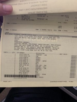

Wow. Had mine replaced at ~38k miles and haven’t had an issue since. We’re now at ~57k miles. 2018 expedition
Attached is a list of parts they used. Wonder if they differ from what they’re putting in yours.
Yep, I just checked my previous bill from the dealer and my list is similar to yours. Mine was done @ 99xxx kms. I'm now at 128,000 kms and no reoccurrence. They only did 2 phasers on mine.
