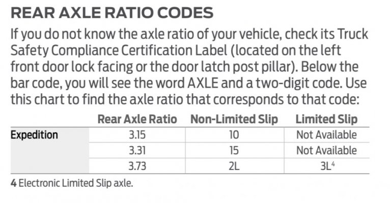

On my 21's window sticker it clearly states:
"HEAVY-DUTY TRAILER TOW PKG NO CHARGE .3.73 NON-LMTED SLIP REAR AXLE"
However, on my cert sticker I have a 3L for the axle code which indicates it does have limited slip. What's up?

From what I have seen, Ford reuses the axle codes. I have seen 3L associated with other vehicles as being 4.10 gears and Limited slip, or other things. It appears they reuse the numbers in different years to mean different things. Where they made the change to not have the LS standard with the 3.73 gears I suspect there is a different code for the 3.73 and Limited slip.
According to the 2021 Expedition towing guide there is a 2L axle code for non-limited slip 3.73. It still lists the 3L as a 3.73 ELSD.

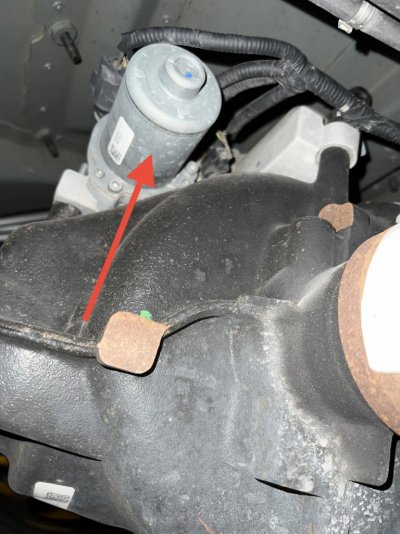

Wow!! This could be yet another big screw up by Ford. The Safety Compliance Certifications Label is a Federal requirement. If it is wrong I would think there could be a fine.
What if the label is correct and you do have an ELSD? Have you had the chance to look at your rear differential?

I think I'd take wakeboarder's suggestion and actually look for the actuator on the differential. If it's there, then the code is correct and they probably hard set the actuator. How many times have companies installed upgraded widgets in their products because they were out of standard widgets just to keep the assembly lines running. Costs them more but maybe not as much as shutting down the line. They just don't enable the upgraded pieces so they act just like standard pieces.
Yes, I will check the rear axle. I'm out of town now so it will have to wait until I get back. I definitely do not have the locker button.

Can you check your rear axle to see if the actuator is there like in the pic that was posted?

The actuator is for Non-Limited Slip axels to allow electronic locking. From what I gather there are 3 types
Non-Limited Slip
Non-Limited Slip w/Control Trac Electronic Limited Slip Diff
Limited-Slip (normal clutch type posi)

I have not seen a true LS offered on the Gen 4 Expedition, only the electronic model. If there was a true LSD that would be news to me.

The picture that I posted was of an ELSD. I was incorrect on calling it an actuator as I believe it is a hydraulic oil pump.
