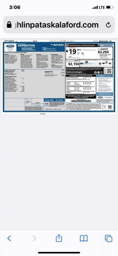

Does your sticker list Control Trac with ELSD.
The actuator is for Non-Limited Slip axels to allow electronic locking. From what I gather there are 3 types
Non-Limited Slip
Non-Limited Slip w/Control Trac Electronic Limited Slip Diff
Limited-Slip (normal clutch type posi)
My window sticker lists 3.73 non limited slip. Hence the confusion. Because my cert sticker lists 3L for limited slip.

I looked at a build for a 2022, when you select HD Trailer Tow, it includes 3:73 non-limited slip Differential. There is then another option item which provides “Control Trac with ELSD”.
for those that have the 3L axle on the compliance certification sticker in the door post, do you have the separate line item on the window sticker?

No, there is not a separate line item for "control Trac with ELSD" on my window sticker. And I do not have the locker button.
The bottom line is, if you do not have the solenoid for the electrically applied limited slip, you do not have limited slip, it really is that simple.
For me, I believe what we have here is a simple "typo" on the door data tag. As with everything else in life, it's rare, but it happens.

I believe that every vehicle with the same config has this "typo". HD tow with 3.73 non LSD axle. The error started when Ford separated the ELSD from HD tow I suspect.

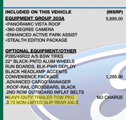

On my 21's window sticker it clearly states:
"HEAVY-DUTY TRAILER TOW PKG NO CHARGE .3.73 NON-LMTED SLIP REAR AXLE"
However, on my cert sticker I have a 3L for the axle code which indicates it does have limited slip. What's up?
Did you ever get to the bottom of this? I'm looking at two 2021's... One is a platinum with the ELDS locker button on the console, the other is a king ranch with no button and the window sticker like yours... BOTH show axle code 3L on the door sticker.
Is it possible that it's still a limited slip rear but without the electronic locking feature? I'm not sure.. I was just looking for the 3:73 confirmation and honestly was expecting two different codes...
Yes. In 21 and newer the ELSD option was not part of the HD tow pkg. It was stand alone. There is no regular limited slip diff, just ELSD. So mine is definitely non limited slip. I'm good with that. I read about lots of issues with the ELSD. Glad I don't have it. The HD tow you absolutely want though. The 3.73 gears alone are worth it even if you don't tow.
