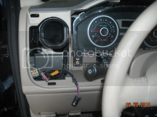

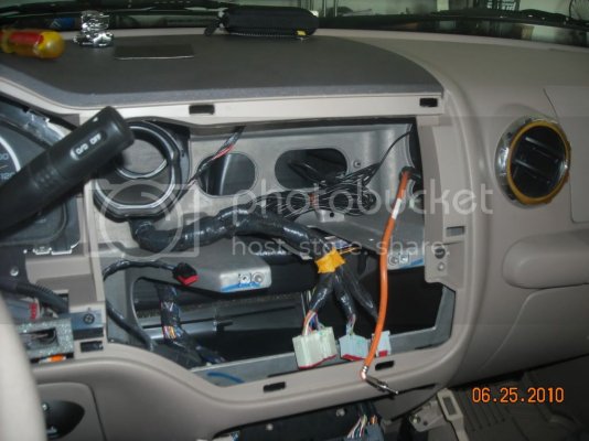

First off you have to remove the dash bezel. There are 2 7mm screws that have to be removed above the instrument cluster. Once those are removed, tilt the steering wheel all the way down, and put the gear lever all the way down to “1” to make room to remove the bezel. Carefully start prying with your fingers from the top of the bezel, working your way around and down removing the clips. You will have to unplug all electrical connections to completely remove the bezel. Here are picture of the bezel removed so you have some idea of where the clips and connections are.

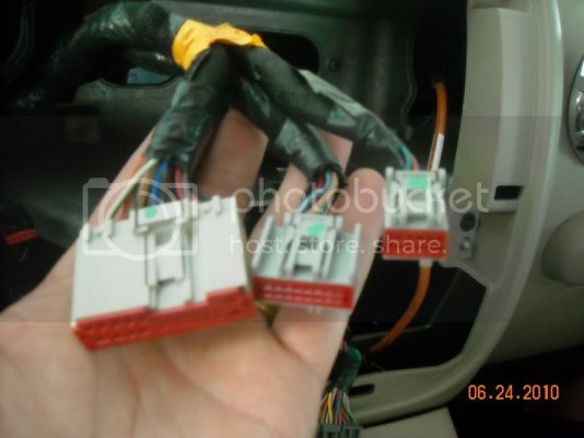

Once the dash bezel is removed, remove the 2 7mm screws from the bottom of the stock radio and slide it out, unplugging the harness in the process. The harness consists of 3 plugs. The large one is for the main radio power and speakers. The small one is for the subwoofer. The middle size if for the overhead DVD player.

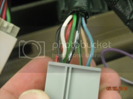

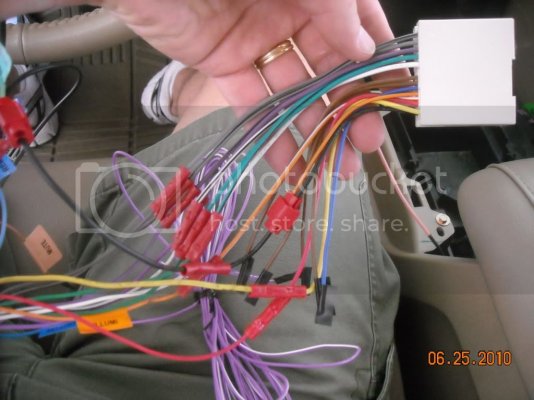

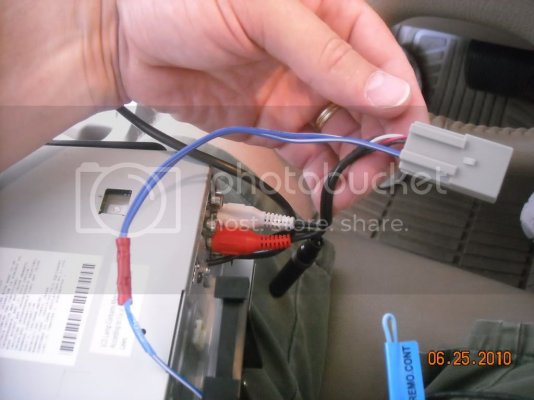

I purchased a Scosche FDK11B wiring harness that came with a main and subwoofer harness adapters. Using crimp connectors, I connected the main harness to the Kenwood’s harness. All the Kenwood color coded wires were correct on the Scosche harness, so there was no guess work in the connections.
The subwoofer connections are fairly straight-forward, but required a bit more work. The color coded wires are a match. The Blue/white power leads from the Scosche subwoofer harness have to be twisted together, and then connected to the blue/white lead off the Kenwood’s harness. However, I needed to install a 1500 ohm resistor between the Kenwood and Scosche wires to prevent the subwoofer from popping on startup. (A crimp connector worked well here as I was able to “hide” the resistor in the plastic covering of the 2 connectors.) Then the RCA connectors get plugged into the subwoofer out jacks on the back of the head unit.

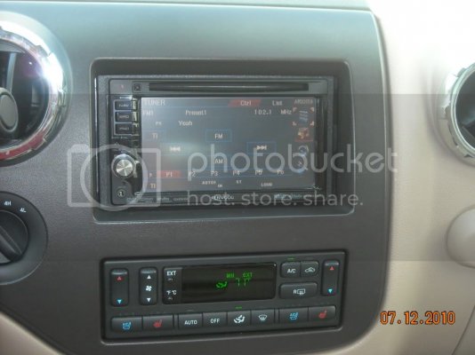

If you were not connecting the overhead DVD player, you are done. Just install the new unit back into the dash, and reverse the steps to reinstall the bezel. Be careful here as the bezel is a tight fit going back on around the steering column and radio at the same time.
Since I wanted the overhead DVD player still to function, I had a few more steps. You can go one of two ways here. First is to buy the PIE FRD03-DVD harness that plugs into the DVD radio harness. It has power and ground leads, and audio RCA plugs that go into the head unit’s AUX in ports. This works only if you have the Audio IN ports on your radio (obviously), and you want the DVD player to perform like it was from the factory….ie audio over the car speakers. I did not have the RCA ports, nor did I want the player to be like that from the factory.

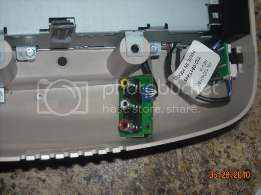

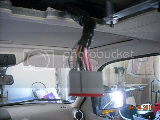

If you want the Overhead DVD to have the same picture as the new head unit, you need to find a way to get the signal from the head unit to the player. Since I could not identify any of the wires in the overhead player, I decided I was going to use the AUX ports that are on the front of the overhead unit. I removed the DVD player from the overhead pod, and proceeded to open that up to expose the AUX ports from the inside. I unscrewed the ports from the player, and pulled them outside of the unit. (see pic below). I then reinstalled the DVD player in the pod.
Now all I needed was the sound to come through for the headphones. Since the sound goes from the overhead unit to the radio, then to the rear seat controls, then back to the radio and overhead unit, this won’t work any more since the factory radio is gone. So what you need to do is splice some wires on the overhead DVD harness that plugs into the overhead unit. Thanks to a thread on this forum (and Smo0othride) I was able to obtain the audio input output leads on the harness. What you need to do is find a way to splice/connect the wire from Pin 7 to Pin 5, Pin 17 to Pin 15, Pin 8 to Pin 6, and Pin 18 to Pin 16. (Basically you are splicing the Audio Out to the Audio In for both the left and right speakers, both the positive and ground leads). I tapped into the wires before the harness plug. Sorry, I don’t have a pic of the wire taps.
Now that you have sound, you need power to the overhead DVD. On the main factory radio harness behind the head unit, you need to hook up both power and ground leads to the overhead harness connector. Pin #6 on the DVD connector (Light green/black wire) is the power to the unit, and Pin #3 (Black) is the ground. Tap into the wires and connect them to a switched power source and ground.
