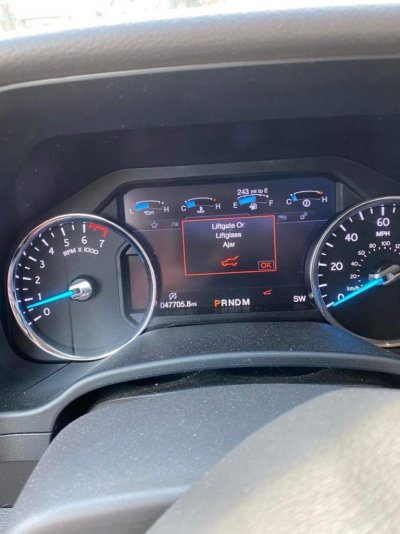

“Lift gate or lift glass ajar”

Mine had this issue constantly on first year of ownership (1st Gen). Fir and Pine tree needles would collect up behind the upper hinges. I eventually learned that I had to clean the whole frame spotless, wax the paint and spray silicon on the rubber gasket. The next 5 years has been without an issue. Nico
