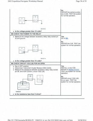

lets look at the radio problem first Try pulling fuse #22 and see if the radio goes off.
If it does then reinstall the fuse and see if it comes back on.
If the radio comes back on after you do the above then remove the Accessory delay
relay and using a ohm meter check to see if you have continuity between pin 30 and 87
Post the results
