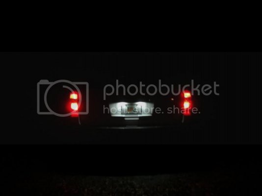

Yes. The reverse bulb is different so you can either drill out the reverse hole in the lights to accomodate the 03 reverse, or just tap into the reverse wires and wire in a 921 socket, and use the 921 bulb (reverse for the 07, I believe).
I went with the latter option.
