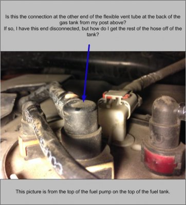

Worked at getting the fuel tank out to check the fuel pump. Have the tank out and on the ground with all connections to the tank removed, except for one ribbed, flexible vent tube that I cannot see how to disconnect from the tank. The view in the picture is from the back of the fuel tank looking forward.
How do I remove this connection from the tank so I can get it out from under the Expy?
Thank you.
the bottom caption for the picture should read:
"... goes to a connection on the middle ..."
not
"... goes to the a connection on the middle ..."

Can't tell what type of connection was used without seeing the ends of the hose. One my first gen it was a combination of hose clamps and quick disconnects.

I do not see any type of disconnect on this line at the back of the tank. It runs under what looks like a protective shield for rocks and debris that is on the driveshaft side of the tank. Maybe I need to remove this shield?
Here is a picture of the connection I am referring to on the fuel pump.

The hose mentioned in my previous posts is just a vent to atmosphere. It ran up to the top of the fuel filler neck and was not connected to anything.

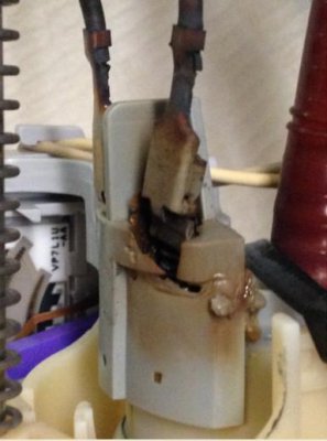

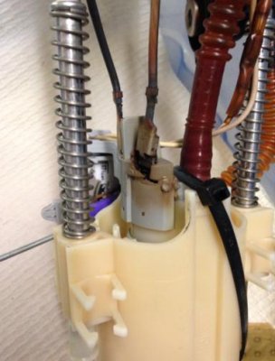

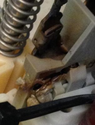

So, tank is out. Pump is out of the tank and it is melted like others have mentioned.
If I can get the part, it looks like it is just the pump motor that is melted.
The melted pump is marked as
Walbro
7L14-9350-CD
F10000275
Quickly searching for these part numbers did not find anything.
Anyone able to find the pump motor and replace it with success?

Fuel pump replaced and vehicle now running. Had the Expy running for about an hour and the motor sounds fine.
I ran out of time looking for a replacement for the fuel pump itself and had to spring for the whole assembly to get the truck back on the road.
I bought the Precision Fuel Pump from Oreillys. The Fuel Pump Module Assembly is
part number A33110. I bought this one because I found it in stock locally so I could get my hands/eyes on it to compare and ensure it was the correct assembly.
There is also another similar assembly for the larger fuel tank, so be sure you get the correct one for the fuel tank size you have. That other part number for a similar Precision pump assembly is A30019. This model is for the EL Expy and, I assume, for the 33 gallon fuel tank. I was able to look them both over and they appeared similar. I went with the one that was identical, the A33110. Again, be sure you get the proper one for your tank. I have no skin in the game for Precision. I don't know them from the others but, again, I got it because I could get my eyes on those parts at the counter.
Thanks to you all for great help.
