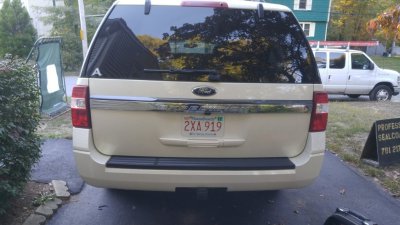

I'll have to look at the badges I removed but I believe there are holes behind the expedition emblem but not the advancetrac. I added the 15-17 chrome trim to mine and didn't have to patch anything. Pretty sure the pin on the expedition lined up with the new trim pin and nothing behind AdvanceTrac. I'll find my emblems tomorrow to check back in
Gixer, how did you applied 15-17 chrome trim to your 07?, Do you have to drill?
Yes I had to drill 6 holes all the way across. I also had to build my own harness for the license plate lights and Glass release button because the newer style harness doesn't fit the earlier models inside the tailgate. The harness really wasn't a big deal and took me a total of 20 minutes with soldering and Shrink tube.

Gix... That trim piece isn't in Tasca's parts book. Did it come with the switch and light or did the old ones fit in the new trim? Or did you order them separately with the new trim?
I'm sure I still have the part number at home but I'll need to look. The part oem is like $450 but I found the moulding itself on eBay from a guy that was local. Only cost me $100 to my door.
The stock 07 button fit but the bulb sockets were different so they needed to be changed. Thats the other reason I needed to mod the harness, bulb sockets and harness molex need to be swapped.
