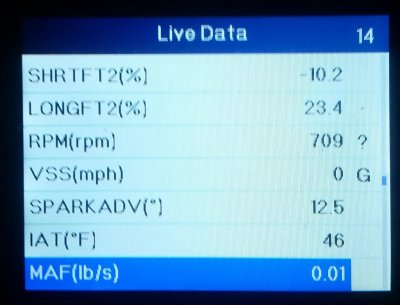

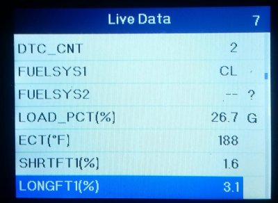

Yea I've sprayed carb cleaner all around the thing already. A couple of times lol. Didn't do anything that I noticed. Checked fuel trims today. Bank 1 trims never went over 10 either way but the long term on bank 2 stayed between 18 and 26! Truck isn't really drivable so this was done at idle.
