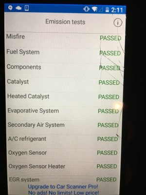

Ok. Well pulled some live data this evening and here is what I got...
SHRTFT1- 1.6% (would go from -4ish to 8l
LONGTFT1- 3.1% (this would vary some but no more than a few numbers)
SHRTFT2- 10.2% (varied widely both positive & negative.
LONGTFT2- 24.4% (varied widely )
SHRTFTB1S1- 3.1%
SHRTFTB1S2- N/A
SHRTFTB2S1- 15.1
SHRTFTB2S2- 99.2
1955moose
Nov 23, 2014
5,981
1,336
Your #2 is your problem. Check those cats, probably gone. So no smoke coming from intake anywhere? And also replace those 2, 02 sensors with Ford or Motorcraft ones. You found your problem. Now the fix. You obviously had/have a bad misfire that caused this.
C
crowncrazy87
Jul 14, 2014
111
Kenton, TN
Well I bought the rig on Monday from a lady who said it just lost power while driving and it wouldn't hardly go 10mph. I originally found 2 fouled plugs fixed that. That's probably what got to the cats. I'll look into checking the cats on that side and see what I come up with.
1955moose
Nov 23, 2014
5,981
1,336
Best way is the screw in back pressure gauge. Why did those 2 plugs foul? Be sure those 2 injectors aren't leaking, and that both those coils are sound and sparking. Your problem sounds like a plugged cat. Were the 2 fouled plugs right next to each other, if so do a compression test of those 2. A leaky head gasket can cause a drop of 2 side by side cylinders.
C
crowncrazy87
Jul 14, 2014
111
Kenton, TN
Opposite banks on the fouled plugs. Not sure the exact cause of it but or how long it had been that way. Once I replaced plugs and wires misfire code has not shown back up. Just the lean codes.
