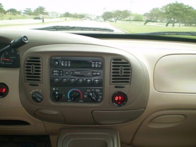

#1: pull the main control panel where your controls are by: 1) "popping" off the trim plate on either side of each vent by sliding something like a credit card, or rubber spatula to ease it out until you can get your fingers behind it and dislodge the snap clips, 2) remove the screws holding this in the chassis; refer to pic attached; its very easy. Then check the plastic electrical connectors. Sounds as if a connector has either come loose, or perhaps broken. they are known to crack after all these years of hot/cold. Reassembly is just the reverse procedure. Sure others will chime in too.

So the control wire plug is good. Any other ideas of what might be going on?
